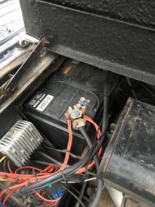

            I just braved the weather to look under my bonnet  – IMG_6394
            The Halfords HB072 which fills the space in my 12V Normale – 68Ah, 550 cold crank amps.
            Dimensions (LxDxH): 261x175x220mm.
            https://www.halfords.com/motoring/bulbs-blades-batteries/car-batteries/halfords-hcb072-calcium-12v-car-battery–4-year-guarantee
            It does the job – so far…
            (sorry about the untidy wiring)
