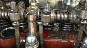

      Interesting day out in the Traction today….. Went to Red Row show which is 11 miles from home. The last couple of miles there the car was flat and noisy and semed to be running on 3 cylinders. When we got there No 2 plug was oiled up so swapped it out but made no difference. Thinking the worst, blown rings, head gasket etc. it put a dampner on the day having had the head totally rebuilt earlier this year.
      Rather than investigate further (mistake) drove the car home as it was on 3 cylinders this afternoon. Once home I could hear a tappet so popped the rocker cover off and low and behold the push rod on No 2 exhaust had come out of the rocker… Squeezed the valve open and levered it back in and all is well again.
      Push-rod
      So that big rebuild bill I thought we might be getting won’t be happening now. With hindsight, I should have taken the rocker cover off at the rally and could have sorted it there…..
