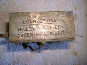

                    189
                      If this is your kind of fuel gauge and you need a replacement let me know. It’s left over from my fuel gauge traumas.
                      David
                      fuelgaugefrtfuelgaugebkfuelgaugeside
                      #26449
                      Roger Grix
                        Seeing these pictures, for “B terminal” read “Yellow Wire” and for “T terminal” read “Green wire” . i.e yellow to green 60 ohms, Green to case 100 ohms.
                        Roger

                        Roger Grix
                          The two studs in the slotted holes will allow adjustment of the coils.
                          Roger
