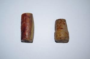

                    Well done Tim, I will have a go when my present float gives out – probably very soon. Some photos would be great if you can puzzle out how to do it,IMGP4591
                    Just managed to upload this pic of my original float – now u/s and a Moet replacement which has also now been replaced.
