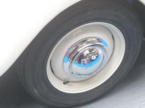

          GSbkEh7mTQGhE61g0bumGg
          these are whats on my 1951 Slough Light 15
          Nigel

          Richard Larter
            Thanks Nigel, so not dissimilar to the French wheels but easier to balance without the central strap. I suppose I could remove the strap and drill the wheels to fit nipples to retain the hub caps but too many projects at the moment. I did wonder if they were the traditional “easy clean” wheels I have seen on some prewar Citroens.
            Cheers Richard

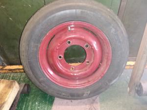

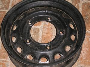

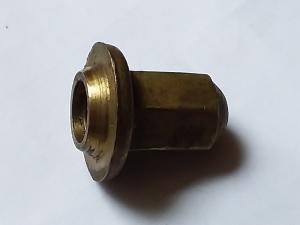

              Richard, nothing Citroën is ever that simple.  Add Slough into the equation and the complications are further increased.
              The rims are very different  under the hubcaps.  Slough rims have a flat area where they contact the drum, unlike the French deep profile.  As a result  they require a different hubnut with a tapered shoulder instead of the captured washer that sits in the valley.  Fortunately, suitable nuts are readily avaiable.
              20200724_101551      20200724_102245
              In addition, there are three lugs pressed into the Slough rim to retain the hubcap.  If you remove the central bar from a French rim you will have no facility for attaching either French or Slough hubcaps!!

                Richard Larter
                  Thank you for the information Bernie, I had not realised the wheels were so different. I wonder if the rims are are French being metric and the centres made at Slough, its a puzzle. Adding hub cap nipples should not be too difficult, just accurate measuring and make it possible to balance the wheels.  I have converted Land Rover wheels into Austin Gipsy wheels by adding hub cap nipples.
                  Cheers Richard
