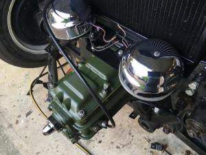

      Traction experts, please excuse the questions, but I’m almost there…
      This thing didn’t even have a speedo cable, so I have no idea when it comes to routing, and the parts manual doesn’t appear to help. Any ideas?
      Thanks, Norman

        Hi Norman
        Loop it across the front of the radiator and make sure it has good curves to avoid it breaking under stress. There must be something you can anchor it to with a plastic tie to stop it moving about. It then runs along the top of the jambonneau secured with a couple of U clips.
