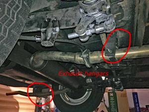

        My custom stainless exhaust didn’t need a bracket on the silencer itself, it just used the original exhaust mounting points and was  absolutely fine
        Exhaust-hangars

          Like David,  I also mounted my stainless system on the Légère using only the original fixings and never experienced a problem in over 15 years.  The car was sold several years ago but I bet I’ve still got the unused bracket somewhere!

            Like wise, fitted a club stainless exhaust to my Roadster, still have the surplus bracket on the shelf! 25,000 miles on, still no problems. My guess would be the two rubber drops on each support, tail pipe and through pipe are essential and should be in good order.
