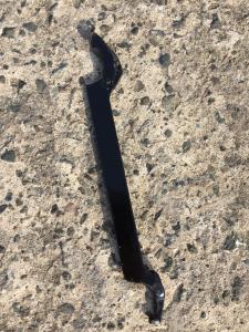

      Thanks very much to all those that helped solve my problems over the past few days. I have packed with graphite grease, Bernie’s advice,  cut, welded, and converted a motorcycle coil spring adjuster which worked a treat. I am now a proud owner of a Water Pump “C” Spanner painted with black smooth Hammerite and included in my on-board toolkit for future use.

              I took the “Twelve” for a drive today no coolant to be seen anywhere accept where it should be, within the radiator. It was such a lovely day I filled up with fuel and drove for approximately 4 hours, no problem with leaks from the water pump seal. Thanks again for your help and guidance in eliminating the leak,  also  helping me through the  fabrication of the spanner required to tighten the water pump seal.8923598D-3981-439B-BEF6-43EB721AF490
