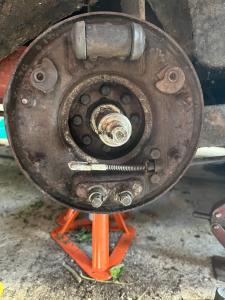

      So I finally got my seized rear wheel off.
      Unfortunately the right brake shoe adjusting cam is seized and the nut badly  rounded (presumably due to a previous effort to unseize it).
      IMG_3037
      Has anyone else had this happen to them? If so, what did you to free it? Is there a way to remove / replace it? I’ve tried penetrating oil and freeze/release spray with no luck.
      ideally I’d replace the cam and nut. I see the cam available in spares catalogs but not the bolt. Is there somewhere I could get one made up?
      thanks,
      Mark

        Hi Mark
        I’ve used PlusGas to free mine off in the past, but yours may be too far gone. My next move would be heat – and then freezer spray. As for replacements, not sure what the specialists are offering but I just posted a long list of secondhand parts that Andy Burnett is hoping to shift. He includes brake parts in the list.
        #33947
        Alain Sauvage
          I had to remove the back plate to apply heat, eventually moved. However the movement after was still very stiff, lubricating the part not very satisfactory. If there is a second hand part with free movement I’d swap it.

            Thanks for feedback. I’ll take off the back plate to attack it properly with heat. A replacement back plate would be ideal if I can find one. I’ll checkout Andy’s list of parts.
