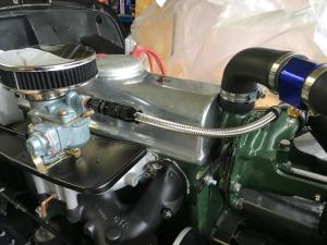

              If you’re like me and you don’t like the idea of fuel in close proximity to the exhaust manifold, you can go for SS Braided PTFE lined Hose using a 5/16″ to AN -6 (male) Hardline Adapter. Yes, I know it doesn’t look terribly original, but it won’t leak!

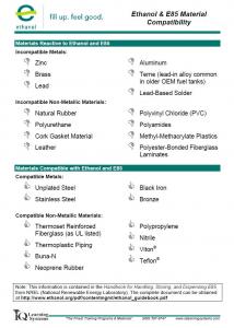

                          And presumably we’ll see more problems with brass pipes coming out of aluminium casting because of this…
                          ethanol & E85 Material Compatibility
                          http://iqlearningsystems.com/ethanol/downloads/Ethanol%20&%20E85%20Material%20Compatibility.pdf
                          So, Paul’s mechanical fix looks quite a good idea.
