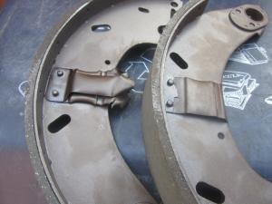

              Another question- both trailing shoes have riveted-on clips? that appear to be for holding the parking brake lever. Both are twisted and mangled so I think I can grind out the rivets and bin them. I’ve never seen these on rear brake shoes before- is it a long-wheelbase thing? How important are they?

                Have you any pictures?
                B……
                #26739
                Larry Lewis
                  Here you go- Whatever their purpose was, they no longer look fit for it. 001
                  #26740
                    Larry,
                    Very interesting, I’ve never seen this arrangement before and am now most curious.
                    Maybe it is worth sending the pics to John Gillard as I doubt he has time to sit and read the Forum.
                    B……
                    #26768
                    Larry Lewis
                      I discussed them with Roger Williams and later ground them off with an angle grinder. Reassembly went well, the brakes are bled and all is OK- thanks for all the help!
