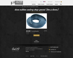

        Hi Martin
        I assume you obtained the seals from a Traction specialist. I also assume the seals for a Big Six are the same as for the French cars and that you are therefore trying to fit this:
        door rubber sealing strip special (for 4 doors)
        When I fitted mine to my Normale I struggled at first and then realized I was fitting them the wrong way round.Once I got them the right way round things went much better. Sorry, my car is not to hand so I can’t provide a photo.

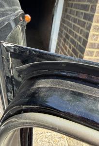

              Good luck Martin.
              I took these 2 photos to show how the seal fit on mine. Not sure if that helps. Maybe your channel needs to be closed up a bit to make it a tighter fit?
              IMG_3594IMG_3593
              #38937
              Martin Pollard
                Thanks Chris
                It maybe time to get busy with the hammer and a piece of wood and close it down a bit
