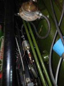

        I have used pumps  like the one in this ad on several Tractions.
        I bought the last one about 10 years ago and my online search back then found a number of similar pumps readily available on the US.
        1. Screenshot_20260531_125542_Chrome
        It is fitted to my 15/6 and, although it is perfectly capable of running the car on it’s own, I generally only use it to prime the system when it has been stood for more than just a couple of days.  It also proved invaluable when we experienced vapour lock in very hot conditions on the way to the Polish ICCCR.
        I have it fitted in series with, and just before, the mechanical pump.  Power is taken from the ignition switch via an overide switch on the dash.

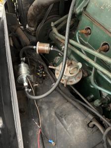

          Bernie, thanks very much for this information.  On my car the mechanical pump is not used at all.  The fuel line goes into a fuel filter and then into the pump.  The line then exits the pump straight to the carb.  On a drive recently the car suddenly lost power and stopped as if it was starved of fuel.  I couldn’t get the car started (luckily it wasn’t too long of a push back to the house).  A few days later I disconnected the hose from the carb, fired up the pump to make sure it was pushing fuel, then connected line back….and the car started up.  Very strange…perhaps an air bubble in the line?  Not sure.  Do you happen to know at what PSI the pump should be operating?

                32PBIC requires 1.5 to 3.0 psi
                35FAI  requires 1.5 to 3.5 psi.
                Exceeding these figures is likely to override the needle valve and cause the engine to run rich.
                B…
                #38325
                Robert Filbey
                  Oh now that’s interesting.  I wonder if that’s what’s been going on with my car.  I have a 32PBIC.  Seems to be hard to find a pump that pumps that low, guess I would need to find some sort of regulator.  Again, thanks for this information.
