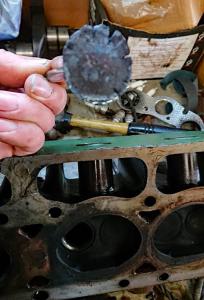

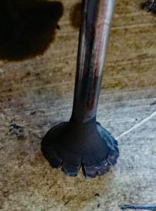

                        I have always run my Traction on ‘Branded’ fuel since I got it 7 years ago e.g. Shell, BP, Total etc. with every 2nd or 3rd tank being the more expensive ‘ultimate’ variety to try and keep the carbon deposits down.
                        Whether any of it makes any difference is a moot point looking at what we have found when investigating low compression on cylinder 3 on my car
                        head_valvevalve_damage
                        Now the head was supposedly rebuilt before I got it with hardened exhaust valve seats, but looking at the other valves some of the heads are ‘thin’ compared to some others so it may be that someone reused a lot of the parts, but that is speculation and there is no way of confirming that.
                        There is some corrosion on the water tube so it may be blocked at no 3 creating a hot spot, but at this stage we don’t know and the car has done around 12,000 miles since I bought it. On the plus side there doesn’t appear to be any damage to the pistons or cylinders so where the bits of valve went is anyone’s guess.
                        BTW the engine was running OK with no strange noises, it just lacked a bit of get up and go and wouldn’t go over 65 mph so it shows how robust the Perfo engine is 🙂

                            That sort of damage usually suggests a valve that hasn’t seated properly and is being eroded, although most of the examples that I have seen have just one segment missing rather than this strange formation.
                            It is amazing how engines will carry on with quite extensive internal indigestion. A friend has a Mercedes SL, which although it ran well after being recommissioned after a lengthy hibernation, developed a tapping noise in the engine, which defied all diagnosis, and eventually he bit the bullet and took off the head. No 5 cylinder had some battlescars on the piston crown, so he delved further and found that the con rod was bent such that it was several mm shorter than standard overall and the tapping was the piston skirt hitting the crank.
                            How had this happened? They concluded that the  hydraulic timing chain tensioner had been slow to react in the initial startup, sufficient slack being present in the valve timing for the piston to hit the valves. Miraculously, apart from a few impact marks on the piston crown, there was no other visible damage to valves, etc. and only one cylinder was affected.

                                Yes it is odd. Maybe the con rod was alreday faulty in some respect. Obviously German over engineering in the valve department. The rest of the engine appeared to be in decent condition. Even so, it has cost quite a bit to put right.

                                  Looking at David’s valve, I wonder if it was not just reground too thin during the head overhaul. that would cause the valve edge to overheat.
