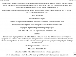

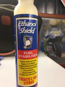

      Has anyone any views, recommendations or advice on this product, would it be advisable for a Traction.
      Would this additive eliminate the problems coming from the increased percentage of Ethanol in the modern petroleum. Would this help with the rubber hose and fuel pump diaphragm corrosion problems. 6AE61761-CEA4-436E-BDAA-2A57BB324A64A373099D-ED26-4ED0-A932-3D729EF6A1E6U
