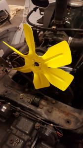

      Another quickie hopefully can it be confirmed that I have the radiator fan on in the correct direction. Am losing the plot a bit as have seen a couple of
      YouTube videos with it the other way around.

        That is on the wrong way. The fan is not directional so it will still pull the air through the rad. The problem will be insufficient clearance as the mounting boss is slightly offset and it will foul the radiator.
        Regards Philippe

          Well spotted yes in that configuration fan hits top of radiator. So reversed the fan and all now okay. Still makes me wonder about the one I have seen that seem to be the wrong way about.
