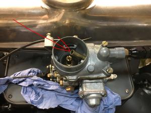

      Hope this isn’t a stupid question. The car is fitted with a 123 distributor, so no vacuum input is required. I didn’t do anything with the vacuum takeoff on the carb, and the car seemed to run fine, but had an annoying odour of fuel. I’ve noticed that after cranking, fuel dribbles from the vacuum takeoff. It’s a new rip off Solex 32 carb. Should I seal off the vacuum takeoff as it’s not being used? Can’t find anything on the myriad of Solex forums out there. Thanks for your help.

        Took the air filter off and looked down the carb throat with the throttle butterfly open. Never seen anything like it. An absolute pool of fuel down there! What on earth can be going on?!

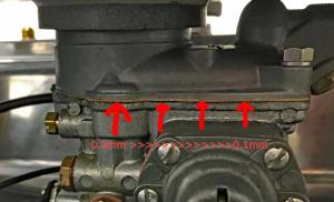

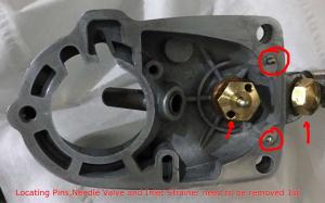

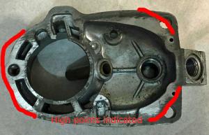

              OK are you sure the carb isn’t leaking between the top and body?
              On my ‘Copy’ Solex I found that the top wasn’t flat and would never seal….
              I found that there was a gap of 0.20mm at the accelerator pump jet area reducing down to 0.10mm at the float end of the top section. Now the gasket used between the top and base is only 0.20mm thick and fairly stiff so was not going to fully take up that gap when the top is fitted and tightened, no matter how hard you try.
              Carb2Carb5Carb3
              Once lapped flat with 600 grit, leak cured.

                I took the air filter off and dried things out. Cranked it with the throttle wide open (as it was most likely flooded). Never, ever seen anything like it. The moment it fired, a torrent of raw fuel shot out of this tube!
                FB89B025-F525-46D7-9DE9-267D1E78638F
                No wonder it was absolutely bathing in petrol! Looking at the parts diagram (and David’s excellent website), it would seem to be some sort of ‘balance’ tube for the float chamber? Could a stuck float do this? Must be a seriously crap copy of a Solex carb ☹️

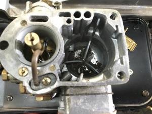

                        Just back from the Netherlands. Lifted the top off the carb. It looked like the float was stuck in the chamber at an awkward angle, so maybe it was jammed, or it was the small flap as Alistair suggested. Hard to tell. Anyhow, lifted the float out to find a whole lot of black sludge at the bottom of the float chamber! No idea as to how this has happened as all the lines are new, and there are two filters in the line.
                        Cleaned it all out, and it now runs fine. I’ll keep an eye on that float chamber.

                                Sure enough however, there is evidence of a wet gasket just where David had the issue with his copy Solex, so it may well have a similar issue there, and could explain the constant petrol odour. So thanks for the info David.
