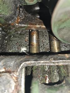

      in the car I recently started working on (1938 11BL) gear engagement requires quite a bit of force on the lever, making it difficult to change gears smoothly – typically crashing into reverse coming out of 1st, or too quick changes between 2nd and 3rd gear (not enough time for the synchros to engage properly).
      Today I looked into adjusting the gear lock mechanism, only to find none of it where it was expected…
      20250831_123108
      Is it safe to assume someone swapped at least the upper cover from a DS gearbox? Is there any way to tell between a 11CV and DS gearbox just by looking at one? Why on earth would someone do this?

        When I first got my 51 Normale it did not have the interlock fitted. Whoever had last taken the top off it had just left all the bits out.
        I haven’t tried to compare them but I would be surprised if a DS cover would fit a Traction box.
        I cant quite get my head around the biting point being high and the cable being slack. If the cable is slack it should mean the biting point would be near the bottom (fully depressed) end of the pedal’s travel. That would mean your clutch might not be disengaging which would make changing gear difficult.
        If the interlock balls are still in the top cover, but the operating rod is not there to move them, that would also make it hard to move the lever.

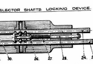

          <p style=”text-align: left;”>If someone adjusted the clutch toggles wrong (too high) when installing one, there might not be enough space for proper throwout bearing clearance and position adjustment.</p>
          If the gear lock mechanism was removed, the 2 balls wouldn’t really cause much resistance, and might fall out of the T piece hole, and I couldn’t find one at all (though access is terrible).
          If it was disconnected and in place, the selectors wouldn’t move at all.
          Is there any Citroen model which might have a very similar gearbox but without the lock mechanism?

            I have solved at least part of the mystery. Car was first registered in January 1938, the last month before the clutch lockout mechanism was introduced. Must have beeen a solution to the heavy and clunky shifting. I will be fitting a later model upgraded cover with the lockout, the godawful way the shifter works now is not worth the originality.
