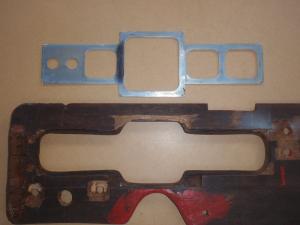

        Hope this helps – just spent the afternoon working on my dash (a major refurb of the horrific work done whilst mine was out in Egypt in the 60’s).
        P9120084P9120079P9120085P9120086
        On my car the gauges are all mounted into a long frame which has two end lugs that then mount onto the metal dashboard panel. On my frame there are 2 screw holes at each end but I have a spare frame that only has 1 screw hole on each end
        The chrome bezel plate screws onto the back of the wooden dash – which you then hope will line up with the gauges when the wooden dash is bolted over the metal backplate.
        I’m just about to do a cut-n-shut on two gauge frames to (hopefully) insert an oil pressure gauge and water temp gauge into a matching cluster.

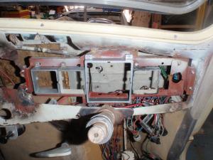

          Hi Paul,
          thanks, looks like mine is deferent  unless someone has modified it i only have the two Crome screws that secure it to the wood panel seams odd thought it should be like yours attached to the metal.7F2FBD58-696A-4769-827A-85FC48002A10 I just have a gaping hole.

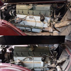

            let me know how you go with the alternator mine has been fitted with one by the previous owner but the car has never run with it and was never wired up.
