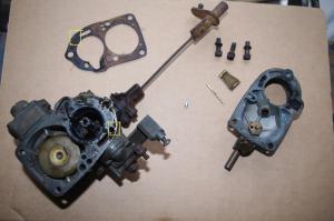

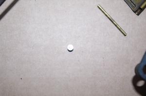

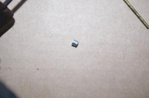

      The regulator was pressed into service on my 11B some time ago and works fine. The dynamo was cleaned up and is now waiting for it’s time to perform again. In the current lockdown, I decided to have a look at the carb. A bit corroded but not beyond salvation I thought. Maybe get one of the club refurb kits… So I started to strip it down. Top cover off with the three bolts removed. Float easily removed. But…….I then realised there was a small cylindrical metal plug which appeared when the carb body had been turned upside down – didn’t see where it came from at all. Is it part of the carb or was it lurking beforehand on the the cloth the carb sat on and nothing to do with the carb? The plug is definitely not threaded, is not a jet, just a small cylindrical piece of alloy. It does fit down one of the holes on the top of the carb though……..? I have trawled through the drawings and diagrams of the 32PBIC in the club archive and can find no mention. Anybody out there have any idea?(see photos)

        But …is it cylindrical ? I ask because when I enlarge your last picture it appears to be very  slightly tapered, larger on the left than on the right,  which might indicate a blanking plug  … but that might just be an optical illusion created by the camera angle.

          Ok Super Sleuth – it IS very slightly tapered, 4mm one end and 4.3mm at t’other. And just fits in the hole in the carb body show in the yellow box, fitting flush with top of body on its taper. And note the gasket has no hole through at this point – other yellow box, so maybe it is a blanking off plug? But why?

                From your picture David it is clear that the same hole is blanked off with a plug – so that must be where mine goes. Interesting that the carb may have to have been machined like that Bernie. Just spotted another seemingly identical plug on the side of the body just below it. Or perhaps it was configured differently for different cars? – it looks like the same 32PBIC was used on Land Rovers, Jeeps, Fiats and even Porches……!
