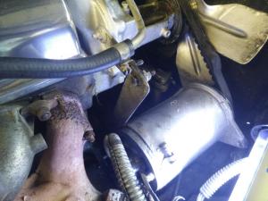

                    The ‘original’ bodge fitting was right hand side. I’ll attach a photo if possible. The mounting bracket looks incorrect.
                    I do have a correct heat shield for the generator, it’s just the bracket that’s leaving me a little confused.802XUD_54

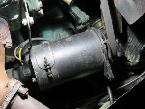

                      I attach a photo of a C39 fitted to my Lt15. I wasn’t able to get a photo of the U shaped bracket that sits behind it – it’s not very complicated except for a curve cut out at the top to follow the curve of the C39 body.
                      PatrickC39 fitted in Lt15

                        My car has been converted to an alternator but I agree with Patrick that it should be a simple bracket attached to the long engine/ gearbox bolt.
                        Cheers Richard

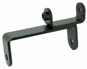

                          CTA supply a bracket for the alternator conversion they do which might give you an idea what to fabricate as per the picture below
                          21571
                          The wide part fits on the gearbox/engine with a long bolt

                            Looking at the bracket in my Lt15 again, it is very similar to the picture David put up, except that it extends upwards a bit more on the right hand side and fits the curve of the dynamo, finishing near the top in board of the end plate (just visible in photo below arrowed). The CTA one looks as if it would do the job for you.
                            Patrick
                            C39 fitted in Lt15 2
