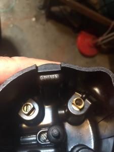

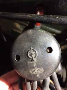

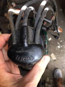

      Does anyone know where I could purchase an old type Lucas Distributor Cap (cracked at Number One) Chris @ TOC is also investigating for me.
      Davy

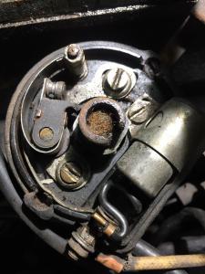

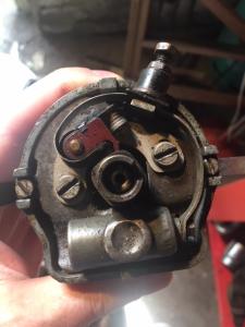

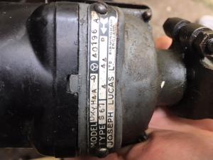

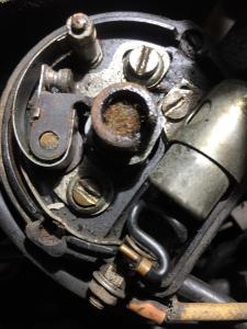

        From these Pics could anyone identify type and part number for Contact Points
        Regards
        DavyB8530D60-0FB7-4671-8400-63F54B95B75E34FE19A7-63CD-4086-834A-76C67B12BA1E
        #23138
        Alistair
          I have a pdf file of the various points etc. Unable to post pdf here….is there any way to PM you?
          I have 1953 Light 15 and changed to electronic points….

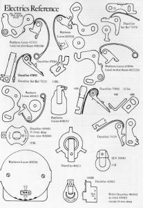

          #23139
          Alistair
            Managed to snip and save as a jpg… this diagram appeared in the Tech articles. Can send the pdf if you wish…?
            points Diagrams

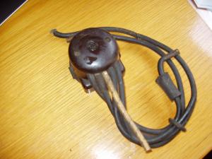

                David,

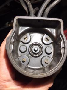

                I have this in my “used stock”:
                P6140095
                It is not Lucas branded and I can’t actually read what it does say, maybe “CI” – so possibly an aftermarket equivalent?
                I also have some new old stock points but shall need to access them over the weekend.
                Meanwhile, let me know if the cap may be of interest – I can take more pictures if you want.
                B…………

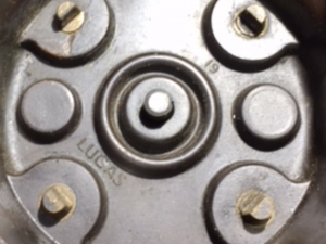

                  David Selfridge
                    Yes Bernie it definitely is Lucas if you zoom in to the inside of Cap Lucas is Stamped with a serial/part number 400316
                    The leads come out at right angles to the Cap and it’s very low frofile.
                    Davy8B16A60A-B8F9-44DD-84AF-F6141DD33AF0
                    #23144
                      Davy,
                      I think we are at cross-purposes.
                      I do not deny your cap is definitely a Lucas part but I am not sure what the one I have is.  All I know is does look very similar to yours with the leads coming out in a horizontal cluster from under a disc cover retained by two screws .
                      I shall give it a clean and look more closely tomorrow – when the beer has worn off!
                      B……………..

                        The diagram at the bottom Shows a diagram of a Distributor Cap to replace Lucas 400316 which is the serial number stamped on my Lucas Cap.   My email address is davidselfridge52@icloud.com
                        Bernie the Cap in your Photo looks like the correct one, could your check with magnifying glass inside for Lucas and serial number or take a photo and zoom into the 2 small flat areas adjacent to where leads protrude for the Stamped Number

                              #23149
                                Davey,
                                I can confirm the Cap I have is a period aftermarket equivalent to a Lucas Parts.  It was made by CI, a reputable manufacturer of automotive electrical components back in the 50s and 60s and some of their parts still appear on e-bay from time to time.
                                There are no numbers inside the cap.  The CI logo appears top centre and there are three digits – probably 223, possibly 228 on one of the side lugs.
                                The following link is to more pictures of the cap.  They are large files so you cn download and zoom in if you wish.
                                https://www.dropbox.com/sh/qqljhdhho536cxr/AABnOXy4Zx5ftvNozgu30jLRa?dl=0
                                If you think it is worth a try I shall be happy to post it to you.
                                I regret my stock of points is all French so no help there I am afraid.
                                B……………..
