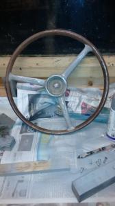

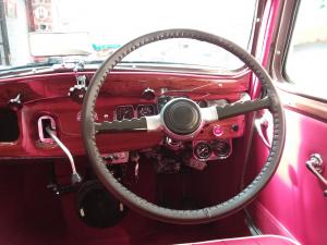

        I don’t know what the Slough wheel looks like under plastic coating. My 1955 Light 15 came with a pre-war 3 spoke wheel with the same problem of peeling plastic.
        I stripped it all off and found that the 3 spokes were cast aluminium.
        I de-rusted the rim, polished the aluminium and sprayed the rim brown.
        Not original but I think it looks pretty good, and a lot less than £350 🙂
        5
        After
        IMG_20170111_173913634
        Before
        Roger

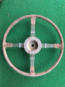

        Nigel Watling
          DSC_1304[5196]

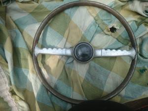

          Hello Roger
          Thank you for your reply.
          This is my wheel with all plastic removed, the alloy spokes are a very rough casting but with some work they could be cleaned up, I could sandblast the steel rim, what sort of paint did you use, most of the u-tube videos I’ve seen use an epoxy base color and then a clear epoxy coating for wear resistance.
          Nigel

          Roger Grix
            I just used a spray can of Halford’s car paint. Grey primer and Vauxhall Brown I think, which was a near match to the wheel hub insert. I don’t suppose it will last for ever but so far it’s OK, after about 5000 miles. Easy enough to give it another coat if needed.
            The spokes did take quite a bit of sanding and I applied a clear laquer. A bit fiddly masking the joint between the spokes and the steel rim.
            I don’t have the facilities to spray paint epoxy paints and a lot of work for a couple of minutes spraying.
            Roger

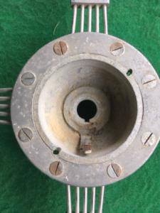

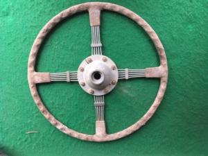

              Paul Barnard
                I found this quite badly deteriorated Blumels 17″ diameter wheel on Ebay for which I gave £20. I couldn’t believe my luck when I found that it had the same size Woodruff keyed fitting on the column. It was easy to polish the alloy hub and then I used some hockey stick foam handle grip which has adhesive on the back and having cleaned the rim as best I could I wrapped the rim with the foam. I finished this off with a leather glove (comes as a kit) which I stitched on.  It is soft and comfortable to use and looks good – I think.sw1sw2sw5IMG_1173IMG_1141IMG_1135

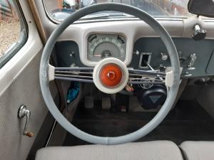

                  20210613_135005
                  Finally got the wheel sorted, took on both Roger’s and Peter’s suggestions and combined them together, polished the boss, painted the two spokes and coated both in a two pack resin and then purchased a leather steering glove, doesn’t look too bad but think i could do a better job of stitching next time.
                  Does anybody know which way the wheel should be fitted i.e with ridges on the spokes up or down?
                  Nigel

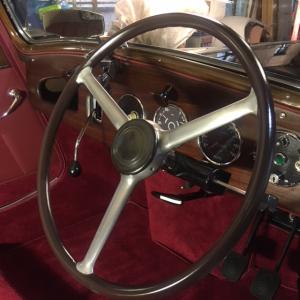

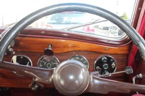

                        I must confess that I did not look that closely at your steering wheel but now that you ask the question, I must say that I have not encountered that style of wheel before.
                        As far as I know, the UK steering wheel was a 3 spoke, like mine, until the 1940’s. John Pressnell’s book shows a 3 spoke on a 1940 model and a 2 spoke on a 1946 model, as shown below in a picture of a car advertised some time ago on eBay.
                        $_57 (1)
                        This was, as far as I know, kept to the end of production.
                        The French 2 spoke  appears to have had smooth spokes.
                        So I don’t know where your “ribbed” wheel fits in.
                        Perhaps someone with more knowledge than me (not difficult) can identify yours.
                        If it was mine, I would mount it the other way up so that you have smooth on top. I have no justification for this except that, to me, that would look right.
                        In the end, as long as it works, and you find it comfortable, that’s all that matters.
