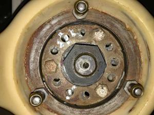

      Madness. Ordered a new two spoke steering wheel 604.099 from Franssen. Whilst it looks identical to the badly cracked original, it doesn’t quite fit! the holes don’t quite line up.
      Anybody else had this issue? Or does anyone know of a solution I can use before I send it back? thanks.

        Norman mine only fits on the flange with 3 bolts, the rest of the holes then don’t fully align which is why you can see the white maker so I know where to refit it 🙂

          Not so fast. The distance between the holes on the steering wheel (centre to centre) is about 58mm. The distance on the steel steering shaft ‘boss’ is about 55mm. There’s no way I’ll get a match.
          Could you maybe measure your brown steering wheel, and let me know?

              Interesting Norman. Measured my spare wheel and it’s near enough 59mm hole centres and my car is a December 52 11BL

                Thanks Roger and David. Looks like I’ll have to send it back to Franssen.
                John Gillard says a Brooklands steering wheel was an option, but they are expensive and may present the same problem.
                My steering wheel has been with the repairer for over a year. I’ll have to get it back from him and attempt the repair myself.
