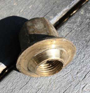

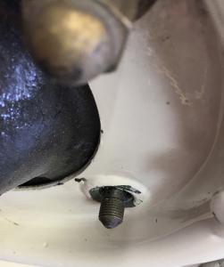

    Norman Anderson
      This 1953 Slough Light 15 was converted to Pilote wheels at some stage of it’s life. All of the wheels were cracked, so I managed to get 5 original stove baked wheels and hubcaps from John Gillard. So far, so good. But on tightening up the wheel nuts (I wish there was a recommended torque value). I managed to strip two of them. (Thank God the studs look ok).
      on checking the TOC spares listing, I see there are special nuts for Pilote wheels and nuts for Slough wheels. Am I therefore, trying to use the wrong nuts for these wheels? Thanks.

        Norman,
        Probably not.
        Both Slough rims and Pilote rims require the same profile wheel nut.  Originally those nuts were brass – presumably to be sacrificial and prevent the hub studs being stripped or broken if overtightened.
        The trouble is most originals are now so worn that even if they appear to be tight they are probably not.  I have a bucket with about 50 of them which are only good for the scrap value of the material.
        When I fitted my Pilotes I managed to obtain a set of (steel) Renault 16 wheel nuts from a friendly Renault enthusiast.  They are perfect but, sadly, also in short supply today.
        However, there are a number of companies supplying suitable steel wheel nuts with the correct thread and shoulder and that is what I recommend.

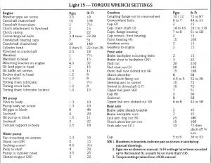

                #26632
                Roger Grix
                  I have found the list of torques.
                  Unfortunately w still can’t upload .pdf to the forum.
                  However the document is in the archives. If you use the TOC index tool and enter “torque settings” you will find a link to Volume 16 (1991-92) Issue 1 (March).
                  There are most of the figures that you may want (but not the wheel nuts).
                  If you have a problem, PM me an email address and I will send you the .pdf
                  Roger

                    #26637
                      Roger I cropped the pdf just to show the Torque part and converted to a jpg so it can be posted as an image file:
                      TA-Torques
