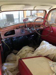

          Mark Robinson
            Hi Bernie, definitely a Big6 H Slough built car.F8BA8A28-0192-465D-B793-CE0664BBCACB
