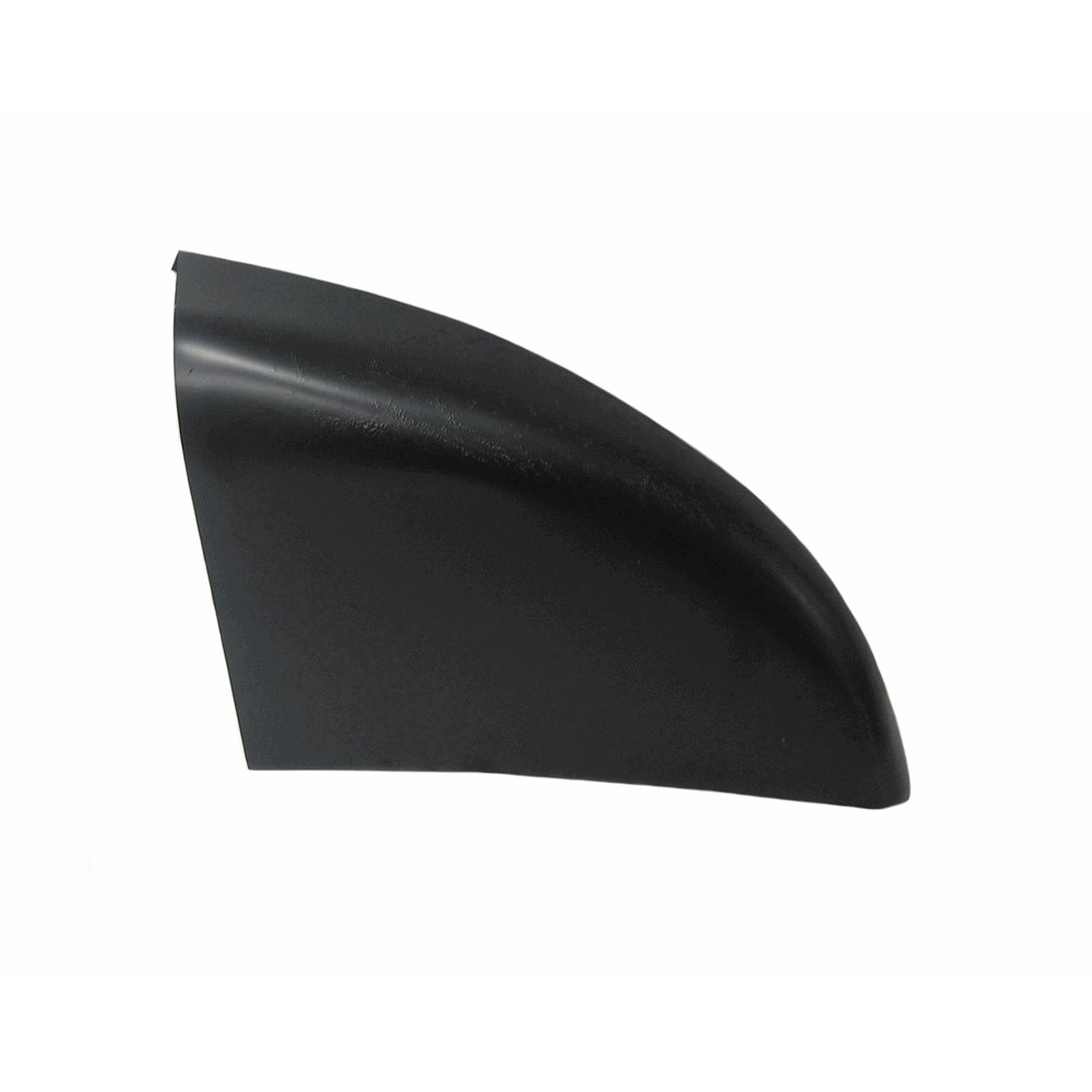

I beg you collective help and advice. I’ve started at the front (you have to start somewhere). Bonnet off. Wheels off, will hopefully do a deal with John Gillard for Slough rims to replace the pilotes. Wings off. What a job. The tail ends under the ‘Radwars’ rotten through. John can do the last 12 inches of the wings for £65, but here’s the question: I saw somewhere the TOC were getting some complete wings made. Are they available, and if so, how much?

I know that fibre-glass wings are available but not “new” metal ones. There are slight differences between the wings depending upon era.
http://tinyurl.com/pt8oow3
The wing end repair is a common job especially when they have been hidden by the wing ornaments for years.

I took my wings to a local bodyshop and he managed to straighten them and smooth them all out ready for final paint, cost me €200 each which was about the same amount for a decent second hand unit (if you can find them) and at least mine are the original ones, so worth putting the work into them.

Mike Tennant, who is based in Micheldean (Just to the west of Gloucester) sells fibre-glass Front and rear wings for Tractions and his prices are more reasonable than CTA .

Thanks Alistair, your link would suggest fibreglass wings run out at around €440 ea. which may well make my steel wings economically repairable.
John G. has recommended a welder in Peterborough, Mark who is not far from me. I’ll ask him for a quote.

You could buy repair panels for the wing ends, CTA have them and I would think TOC Spares as well as Fransens will stock them then they just need welding on (coughs)
